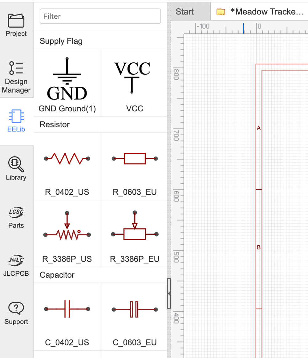

First, there is a built-in set of generic symbols and footprints for common parts like resistors and capacitors, power symbols, headers, etc., called the EELib:

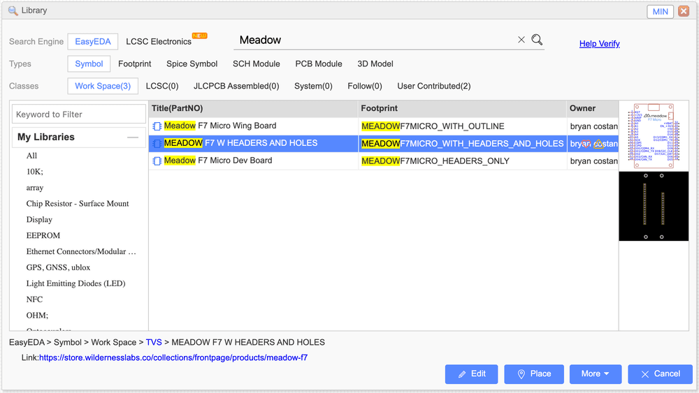

You can access the parts library by clicking the Library button title on the left toolbar:
title
You'll use this window a lot, so it's worth a deeper look at it:
title

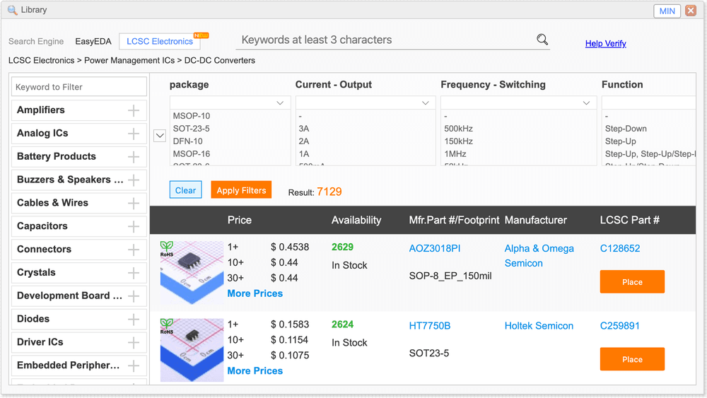

First, there are two search engines, the EasyEDA one (above) and the LCSC Electronics search (below), which provide a very different UX and parts:
title
LCSC Electronics is the Chinese equivalent of DigiKey and they own EasyEDA and JLCPCB (a Chinese PCB fabrication company that is optionally integrated into EasyEDA).
The benefit of using LCSC components is that you can order your PCB to fab at JLCPCB and LCSC can provide affordable assembly at the same time.
LCSC Drawbacks
This can be incredibly convenient, but today has two major drawbacks. First, we've found that in practical scenarios, no single supplier ever has all the components needed for a design, and LCSC, while incredibly large, is no different, preventing them from actually being able to assemble most IoT boards. Second, while useful, the LCSC search UX is no where near as good as websites such as Octopart.com or OEMSecrets, both of which provide a very powerful and easy to use component search that integrates all of the major worldwide component suppliers.
Search Types and Classes
There are two other parts of the search worth noting, the Search Types and Classes:
title
Type :: Symbols
When doing schematic design, you'll almost always be searching for Symbols, which are the logical drawing representation of a part. We'll talk about Footprints later, when we get to designing parts.
Classes
Classes refers to the where the library comes from:
  • Work Space - This is where your own parts get put.
  • LCSC - The part was contributed by LCSC.
  • JLCPCB Assembled - This is largely a subset of the LCSC parts, since not all parts available in the LCSC catalog are available for use in assembly.
  • System - These are the built-in parts. They are curated and nearly guaranteed to have the correct pinout and footprint.
  • User Contributed - As the name implies, these are public parts contributed by users. This group consists of the largest library of parts, but you'll want to verify their footprint and pinout, as they are not guaranteed to be accurate.

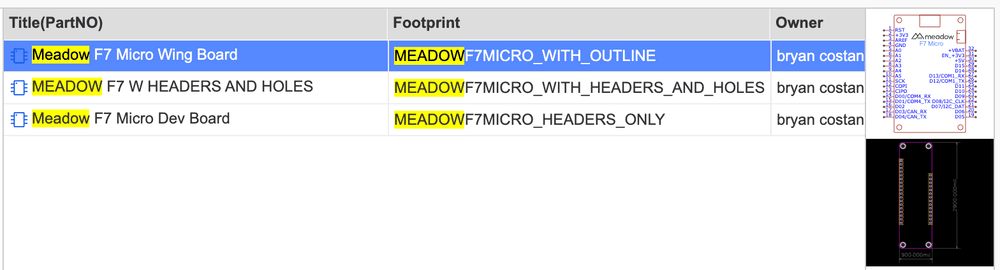

Adding the Meadow

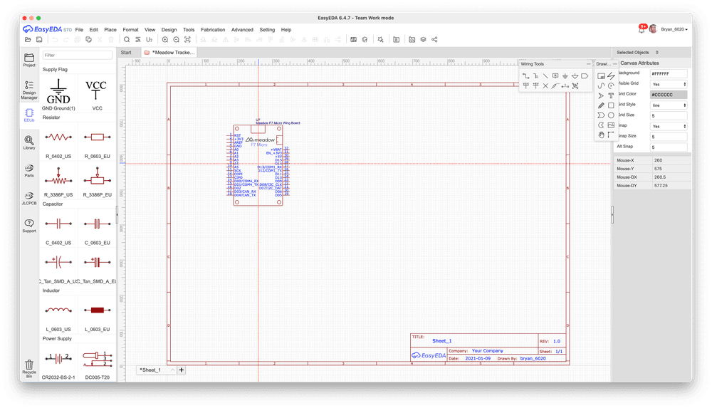

Our design is based around Meadow, so search for Meadow, choose the one that has the board outline (since we're making a wing, it'll already have the correct board shape) in the footprint:
title
Then click the Place button to place it in your schematic:
title

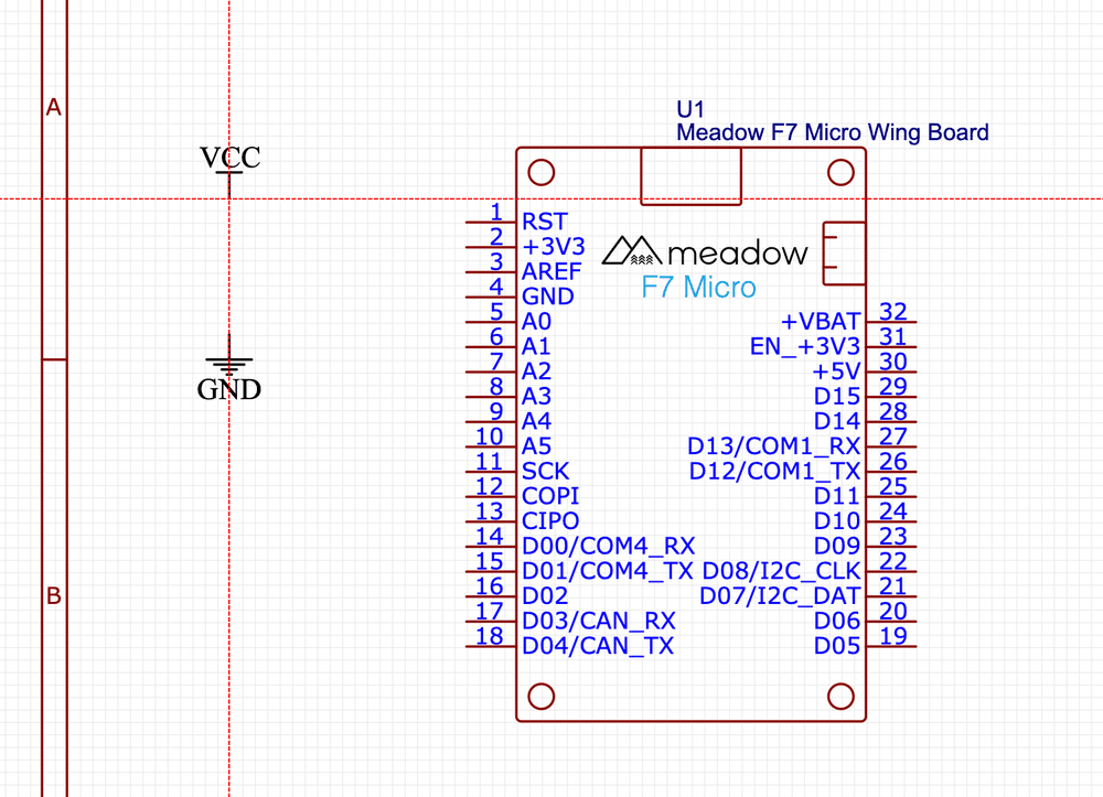

Power, Ground, and No-Connects

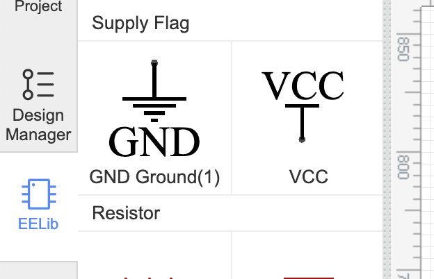

The first thing we're going to do is connect our ground and power rails. Select the EELib on the left toolbar and then click on the GND symbol:
title
Then, place it to the left of the Meadow, and do the same for the VCC symbol:
title
When you're done, hit ESC or right click to cancel out of the tool.

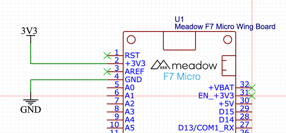

Nets
Whenever you create an endpoint like this, it becomes a net, and anywhere else you drop an endpoint of the same name, they will be physically connected in the design, even if they don't appear connected in the drawing.
Wiring
Next, either press the w button, or click the first icon in the Wiring Tools toolbar to switch to wiring mode:
title

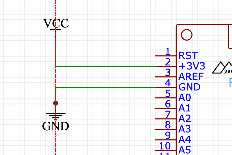

Next, connect wire up VCC to 3V3 and GND to GND:
title

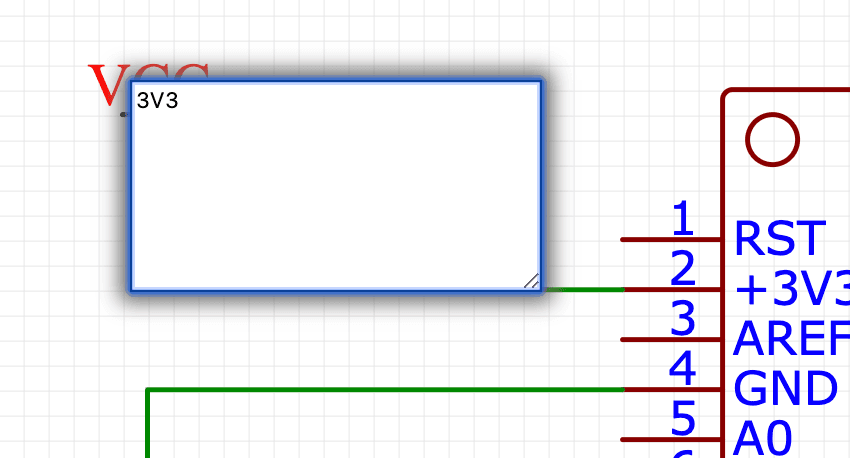

Rename VCC -> 3V3
It's good practice to be specific with your power rail naming. With Meadow projects, you'll often have at least two power rails, a 5V one, and a 3.3V one. To rename, double click on the VCC text and enter 3V3:
title
Adding No-Connect Flags
Unlike KiCAD, EasyEDA requires all connections to be connected or explicitly terminated, otherwise a Design Rule Check (DRC) will fail.
Since we already know that a number of leads on the Meadow won't be connected, we can use the no connect flag tool to mark them with a termination.
The no-conect flag tool appears as an "X" in the Wiring Tools toolbar.
title
Unfortunately, there is no hotkey for this commonly used tool, so select it, and then add no-connects to the RST, AREF, +VBAT, and EN_+3V3 pins on the Meadow:
