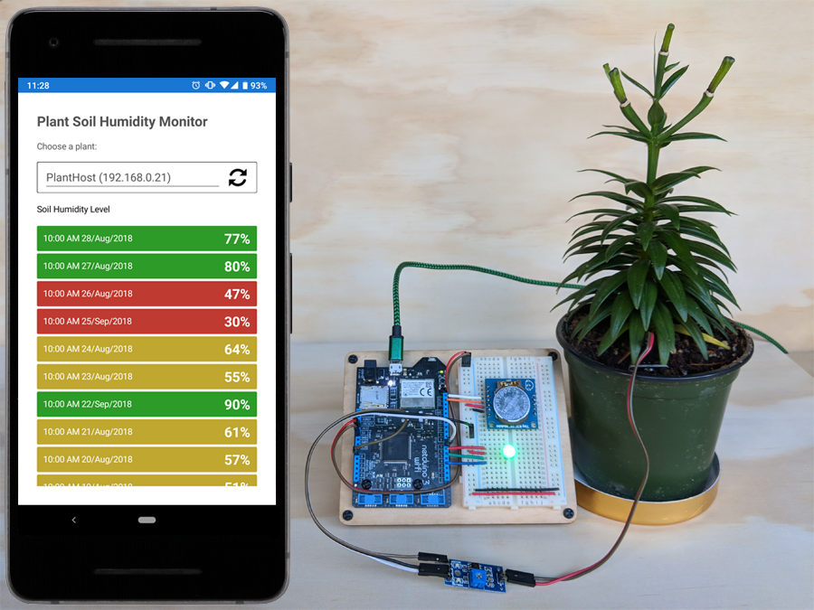

Monitor a Plant's Soil Moisture with Netduino and Xamarin!Monitor a Plant's Soil Moisture with Netduino and Xamarin!

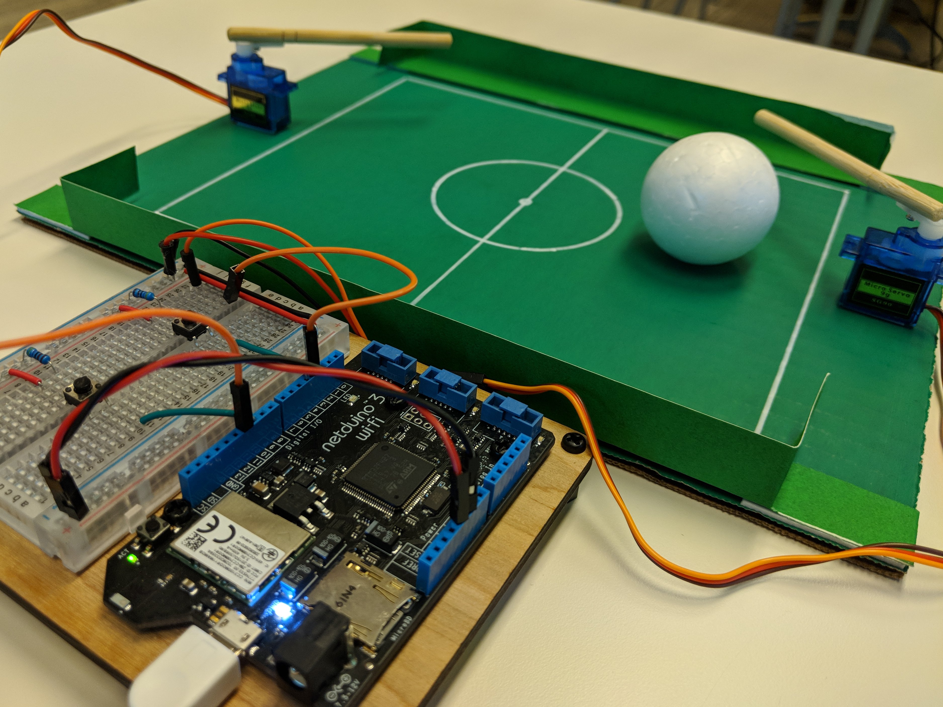

Play Soccer with Netduino Using Servos and Push ButtonsPlay Soccer with Netduino Using Servos and Push Buttons

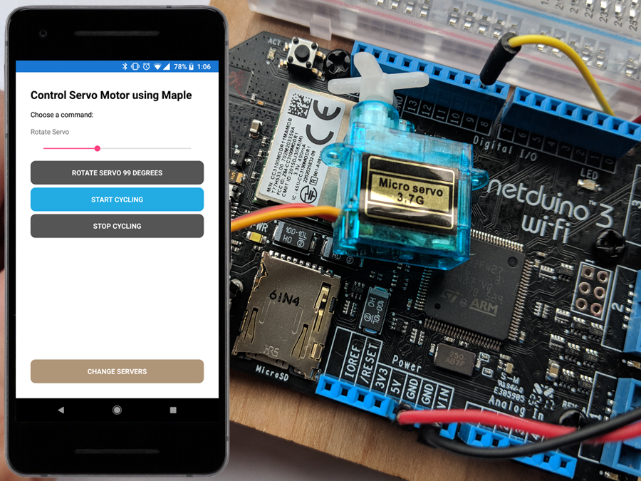

Remote Control a Servo Using Netduino and Xamarin!Remote Control a Servo Using Netduino and Xamarin!

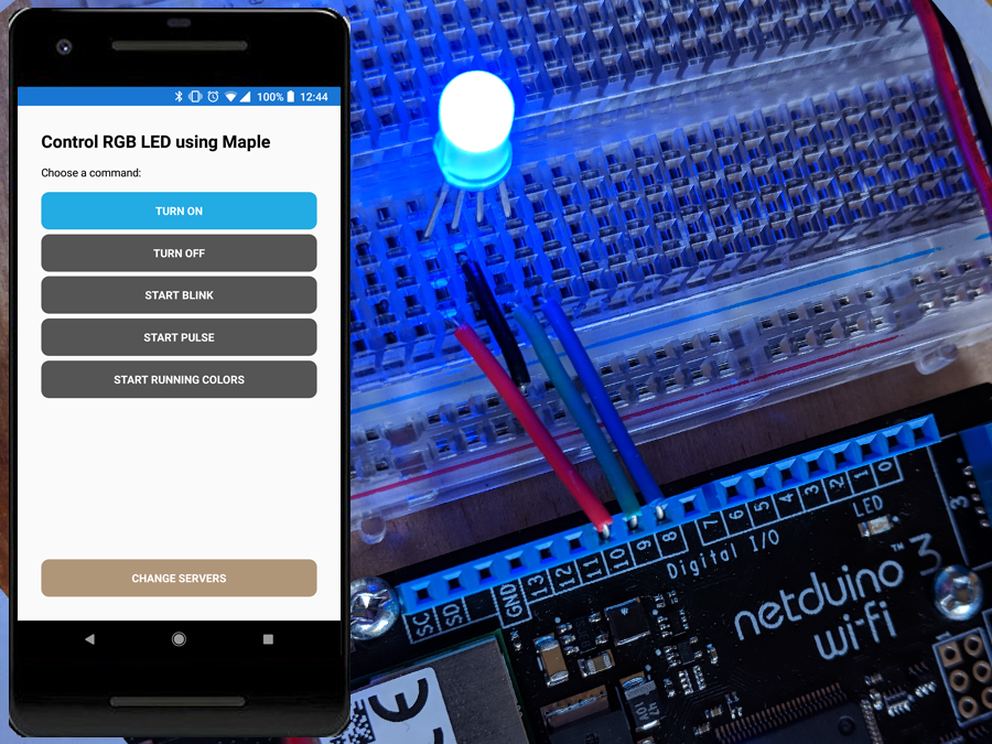

Remote Control an RGB LED via Netduino and Xamarin!Remote Control an RGB LED via Netduino and Xamarin!
