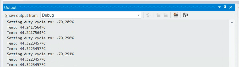

The debug output can then be seen in the output window in Visual Studio:
